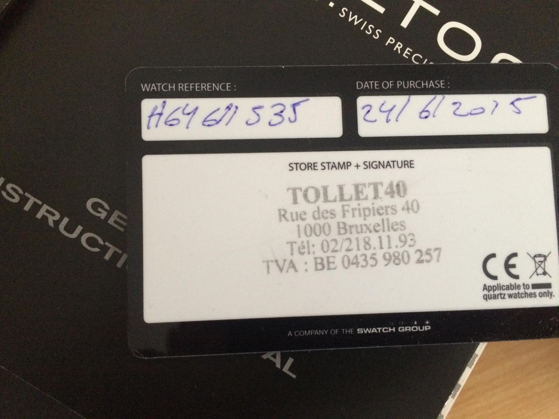

    I mene čudi, kako je moguće da tako loše izgleda posle godinu dana.
    Da ne bi bilo, da krijem.. evo priložio sam fotografiju garancije .
    Usput upravo sam dobio odgovor od Hamiltonove centrale u Biellu ,CH.
    Za koroziju su rekli da odem kod Swatch-ovog ovlašćenog servisa u Skopju ( Božinovski) . Oni ne prodaju Hamilton, ali jesu oficijalni serviseri i distributeri za Grupu Swatch.
    Evo odgovor za kaiš:
    We would like to inform you that leather is a natural material subject to natural ageing. Depending on your wearing habit, the strap should be replaced regularly for reasons of safety (security of the watch on your wrist), as well as aesthetic and hygiene reasons. In normal, daily wearing conditions it has an average life of six to twelve months.
    Po mome, bez veze odgovor, bla bla . Sat od skoro 500 EUR a kaiš se raspada posle jedne godine.
