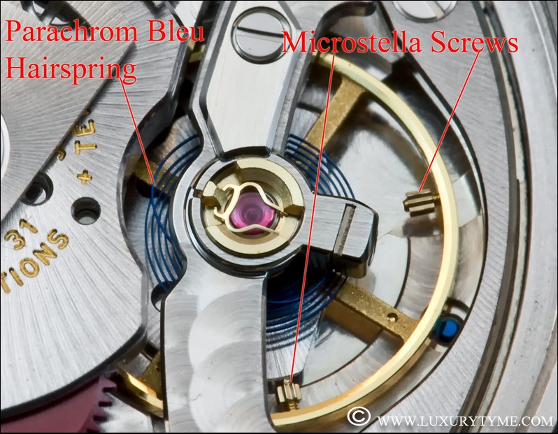

    Microstella šrafovi služe za podešavanje tačnosti.
    Naziv: 3135.jpg, pregleda: 396, veličina: 136,8 KB
    The glucydur balance wheel of the 3135 uses the Microstella system for making minor adjustments in timing. The system is comprised of 4 screws at equilateral distance points along the balance wheel. If they are moved towards the center of the balance wheel, the rate will speed up. Moving them away from the center will slow the rate down.
    Who Makes a Better Movement - Rolex or Omega? | Luxury Tyme: The Rolex Reference Page

    Hvala na vizuelnom prikazu, na pamet mi ne bi palo sta je, mogao bih do prekosutra da gledam
    Drago mi je sto ima znalaca na forumu da razrese sumnje, nas mladjih i nedovoljno edukovanih
    Ako ima jos nekih razlika i saveta, vrlo voljan da saslusam, kao i vecina forumskih clanova verujem
