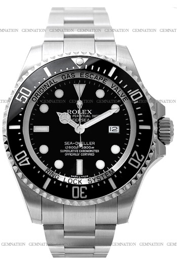

Rolex
[TD="class: watch-detail-attribute, bgcolor: #FFFFFF"]Water Resistance:[/TD]
[TD="width: 5, bgcolor: #FFFFFF"] [/TD]
[TD="class: watch-detail-value, bgcolor: #FFFFFF"]3900m / 12800ft[/TD]
