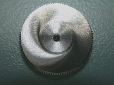

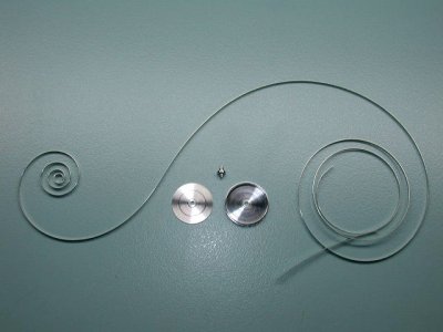

I have ‘dissected’ a Bulgari labeled Girard Perregaux modified 2892 for you. So let’s take a closer look at it starting with its source of power, the mainspring. While not being very high, this is quite a strong mainspring and provides the movement with a more than adequate supply of torque. The barrel arbor has a small diameter relative to the size of the barrel. This is in keeping with most modern movements that use fairly long mainsprings. This results in the mainspring taking up about 75% of the available space, as opposed to older movements whose mainsprings only utilized about 50% of it.
Picture 2 shows the barrel complete. Like the rest of the watch train, it utilizes micro gear toothing. Also known as ETA style teeth. This particular shape, invented by ETA, was chosen for both the wheels and pinion leaves, in order to improve the efficiency of energy transmission by keeping friction to a minimum. Most modern movements, regardless of the factory producing them, have switched over to these style teeth. I think it was Curtis, after much research, who gave us a pretty accurate description of these teeth quite a while back.

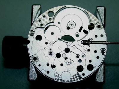

Picture 3 shows the complete train and the escapement. Nothing fancy there, just overall good basic engineering. Note that the wheels are made of glucydur and the pinion leaves are made of steel. Dissimilar metals rolling together produce considerably less friction than if they were made of identical material. All the wheels in quartz watches, high grade ones included, are made of brass. Due to the fact that there is much less torque in a quartz movement, there is no need for the greater strength of the glucydur wheels.
The main plate, like almost all of the rest of the bridges and plates, is made of stamped brass. Most manufacturers rhodium plate these, both for aesthetic reasons and corrosion resistance.

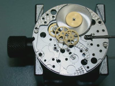

Here is the going train and barrel sans bridges. The brass colored wheel on the barrel is the ratchet wheel.

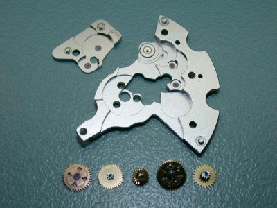

The inner workings of the wheels that fit under the barrel bridge. The ones on the left facilitate hand winding, while the one on the right, the ratchet driving wheel, is the final working wheel of the automatic unit. The spring, together with the smaller diameter steel wheel, serves a double function. The part engaged with the brass colored wheel functions as a click. While the part resting on the steel wheel, functions like a clutch. Forcing the wheel to be engaged during hand winding, and allowing it slip and move out of the way when the auto winding is engaged. The football (rugby for our European readers) shaped post that it turns on determines its free play in both directions.

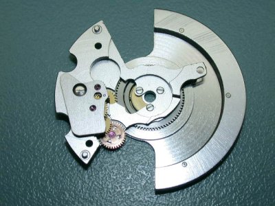

The automatic winding train. The wheel second from the right is the reversing wheel. This wheel, together with the middle wheel, facilitates winding in both directions. The first wheel on the left is the intermediate reduction wheel. One can clearly see the jewel that replaced the stud. It sits on the small stud fitted at the top 12 O’ clock position of the automatic winding bridge.
Here is the auto winding unit complete, ready to be installed in the movement. With weight upside down one can clearly see the heavy weight riveted to its circumference.

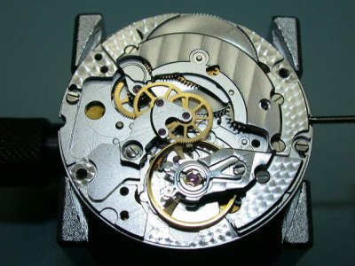

What amazes me as a watchmaker, is how well these teeth work. One can easily check this out by assembling the going train of any high grade watch that has the epicycloidal teeth. Without oiling any of the pivots, give the great wheel a push with a thin oiler. Now do the same with an ETA 2892, or even a Rolex 3135 for that matter. The wheels of the latter turn much more freely.

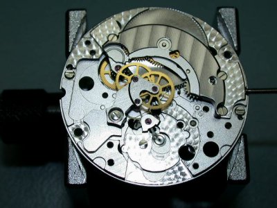

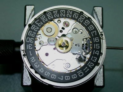

The dial side of the movement with stem, setting and winding system installed.
The complete dial side ready to be fitted with a dial. The large brass wheel at the 11 O’ clock position is the calendar driving wheel. The brass tooth peeking out from under the steel wheel cover, is the tooth that actually flips the date. This ingeniously simple design has been copied by many other manufacturers due to its simplicity, reliability and the fact that it gives a virtually instantaneous date change without needing extra parts. It’s also foolproof, such that one can change the time whether it’s engaged or not without damaging anything.
