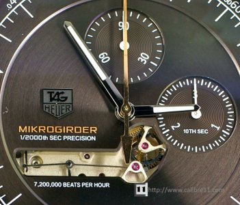

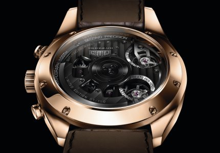

The Mikrogirder movement is based on the in-house TAG Heuer Mikrograph movement, which you see below. The magic of this movement is the dual-chain approach: a separate escapement for the watch (top right, 28,800 beats per hour) and the chronograph (bottom right, 360,000 beats per hour).

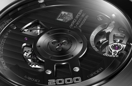

The Mikrogirder movement still uses a dual-chain approach- but instead of two traditional escapements as per the Mikrograph and Mikrotimer, you only see one, which is used for time-keeping (28,800 bph). Instead of a balance wheel and hairsrping, the regulation of the chronograph is achieved via three micro-beams, or girders. You can see the three beams in the window below.

“The anchor has a very specific geometry without pallets, and is manufactured as a beam. If you accelerate the anchor wheel you transform the kinetic energy of the anchor wheel into potential energy in the beam. Now you need an oscillator- one that’s very accurate. It’s a small beam that is calculated to have the first harmonic (the lowest frequency) at 1000hz. To reach this harmonic you need to transmit a level of energy to reach the harmonic. There’s a small contact point between the anchor beam and the oscillating beam [the coupling beam].”
So, to summarise, the three beams have the following roles:
- Excitatory beam: generates energy by transforming kinetic energy into potential energy
- Coupling beam: transforms the potential energy to the oscillator
- Oscillating beam: generates the right frequency
The benefit of this approach is that it allows a frequency of greater than 600-700 hertz to be generated- in the case of the Mikrogider Concept, the movement produces 1,000 hertz, meaning 7.2 million beats per hour and accuracy to 5/ 10,000ths of a second, or 1/ 2,000th.
