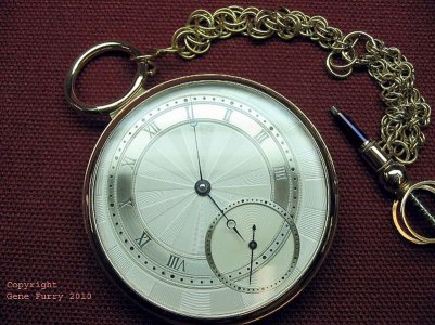

Dobro veče!
Specijalitet za sve ljubitelje džepnih časovnika.
Gene Clark 1948 - 2006
Most tourbillons are driven by the 3rd wheel and thus the tourbillon carriage is considered the "4th wheel" (which is why a seconds indicator is often incorporated into the carriage which while rotating, if there is a 60 division ring on the dial, it will function the same way a hand attached to a 4th wheel is used to measure seconds.)
In No. 5, however, there is a standard 4th wheel that carries the second hand and the tourbillon carriage is driven directly by the 4th wheel at a 1:1 ratio. This arrangement requires less power than normal . . . a much weaker mainspring can be used. This allows for a longer spring to be used, and therefore increased length of the spring can be used giving this watch at least a 56 hour running time while still maintaining steady amplitude. The acceleration and deceleration of the tourbillon cage, five times per second, is also more controlled.
A complicated stopping (hacking) device is employed that stops the seconds hand exactly on the second. This allows very precise synchronization of the watch to a master time signal.
Clark No. 5 was completed in 1994 at a cost of approximately 2,000 hours, in 18K pink gold case measuring 52 mm across.
The watch was sold at Sotheby's Dec. 8, 2006 Auction in New York

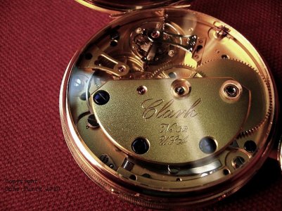

Dobro veče!

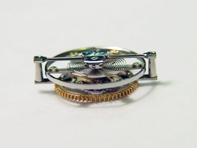

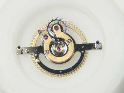

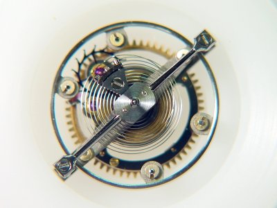

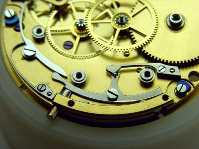

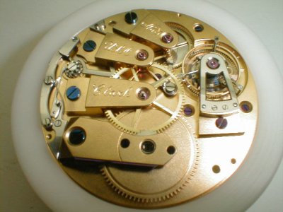

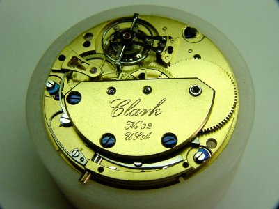

Evo ga još još jedan časovnik iz serije turbiljona koje je uradio Gene Clark, ovoga puta to je Clark No. 32.
Gene Clark #32 - 01.jpgGene Clark #32 - 02.jpgGene Clark #32 - 03.jpgGene Clark #32 - 04.jpgGene Clark #32 - 09.jpgGene Clark #32 - 07.jpgGene Clark #32 - 05.jpgGene Clark #32 - 06.jpg

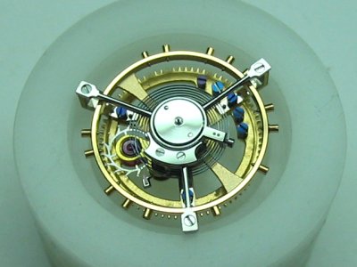

Verujem da će Vam svakako biti interesantno videti kavez turbiljona pokazanog detaljnije na poslednje tri fotografije.
