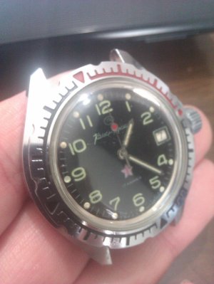

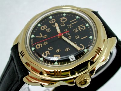

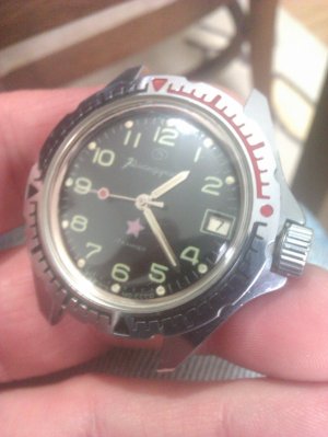

Komandirskie:
Form: Round case with crown protector, chrome or gold plated.
Production: 1980s till 2000s.
Movements used: 2409 and 2414.
Hands: Komandirskie (hour hand in the same style as minute hand, red or silver second hand).
Bezel: usually black and red dots without lume dot, numerals and triangles as well as a black bezel also possible.
Not used: This case type probably offers the widest range of possibilities. 2416 movement was not used. No Amphibia hands.
Form: round case without crown protectors, stainless steel. This case is very similar to the Amphibia case, yet the crown is smaller and more roundish. The case back is different too.
Production: late 1990s till present?
Movements used: 2416.
Hands: Komandirskie
Bezel: black and red dots without lume, in the 2000s some new styles appeared.
Not used: -
Form: cushion shaped case with crown at 2 or 3 (rare), chrome or gold plated.
Production: 1980s till early 1990s.
Movements used: 2414.
Hands: Komandirskie.
Bezel: only black and red dots without lume.
Not used: other bezels, movements or hands.
Generalskie:
Form: star shaped case with crown at 2, chrome or gold plated.
Production: 1980s till present.
Hands: Komandirskie
Bezel: Generalskie bezel (this bezel was usually only used on this case type, in the mid 2000s some Komandirskies were produced with this bezel as well).
Not used: any other bezels. Until the 2000s these watches were marked Generalskie in cyrillic on the dial, later they appeared with Komandirskie on the dial (in Cyrillic) as well.
Form: round case with crown protectors, chrome or gold plated – this case looks very similar to the Komandirskie case at first glance, but it’s actually larger. The difference can be most easily spotted between the lugs. On the Generalskie case the case is not being covered by the bezel when you look from above.
Hands: Komandirskie (often combined with the second hand with lume dot), sometimes Amphibia.
Bezel: the red and black dots bezel without lume dot.
Not used: any other movements or bezels. These watches can be marked both Generalskie or Komandirskie on the dial.
